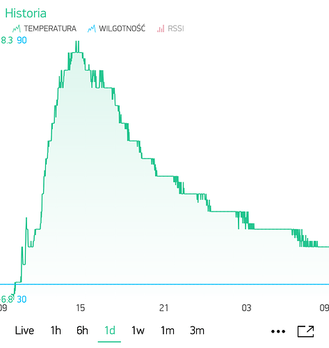

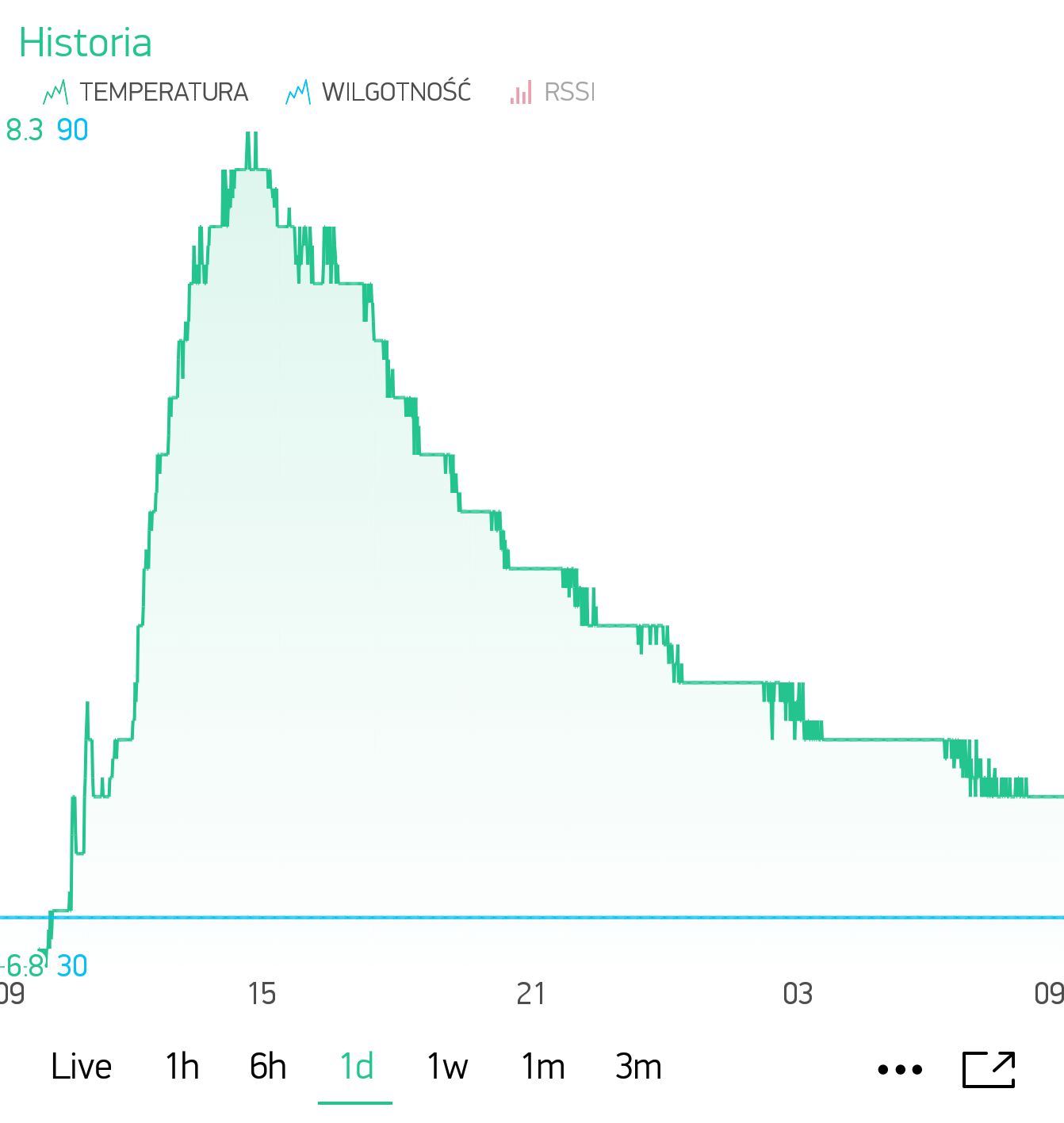

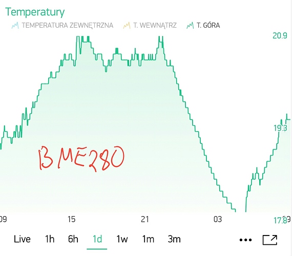

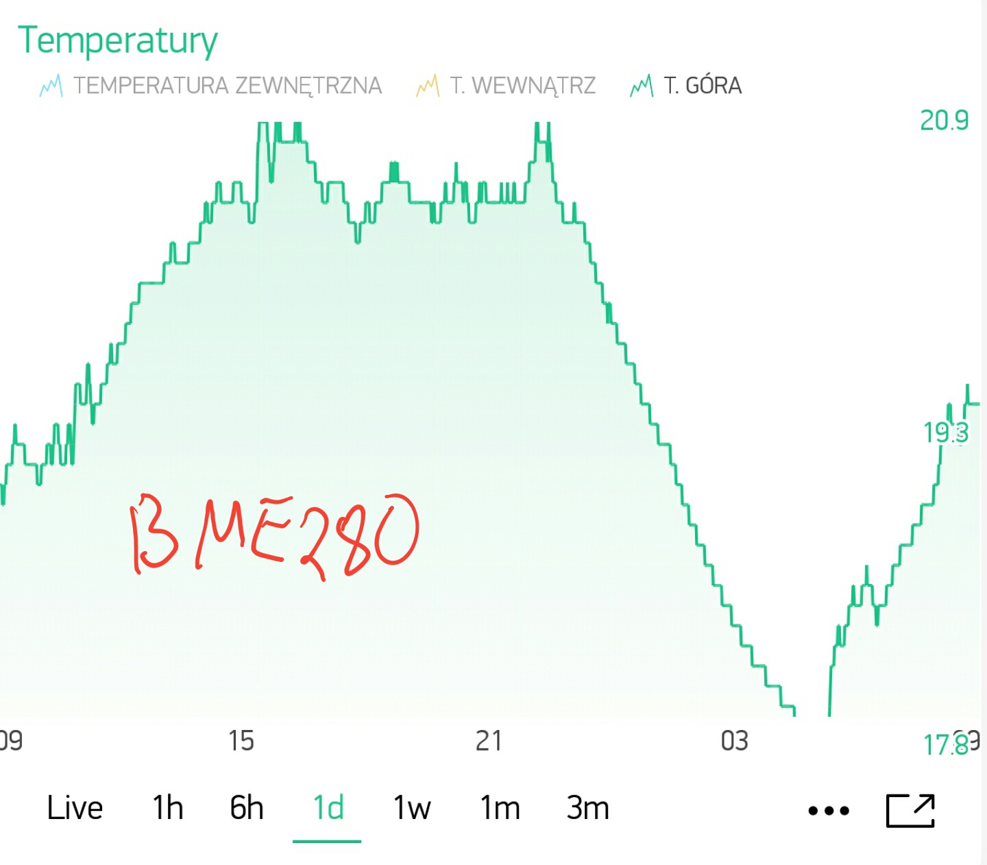

So look at a day long readings, where a finest steps are 0,1°C. Both are good and “stable” (I don’t know how many read errors they caught in that time, but it doesn’t influenced the overall)
The DHT is read twice a minute, the BME once.
First is DHT. Ignore the spikes at rising edge. They are true.
