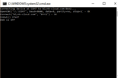

Hello. Please show what console shows after you run blynk-ser.bat

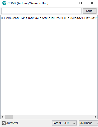

Hm… What does serial output of Arduino IDE shows?

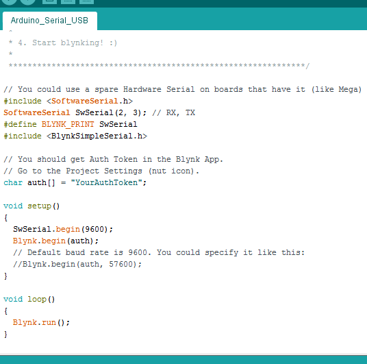

@Maryam_19 post your sketch (formatted with </>) and have you entered the correct token in your sketch i.e. does it match the Blynk project token?

format the sketch so we can be sure you have the correct libraries
This is the code i am using and i update it with my auth token and upload it.
@Dmitriy I have already read this whole thing. but still no use
@Maryam_19 so you are not using the recommended sketch.
Read this https://github.com/blynkkk/blynk-library/wiki/USB-Serial and use the link to the sketch (which is in the Arduino IDE).
