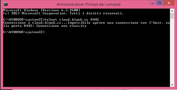

My router has the port 8442 opened.
But I have this result:
Now I have a black windows with cursor.
It seems without errors, but no connection.
cloud.blynk.cc
? Where did you get it? Should be blynk-cloud.com
Yes, my mistake.
With blynk-cloud.com 8442 I have a black windows with cursor. After few seconds I have prompt.

Please post your code. Also what exactly ethernet shield do you have?
I use Ethernet shield w5100

Are you able to connect to sites without Blynk i.e. is the W5100 actually working?
Yes I have tried to use as a webserver and it works well.
what can I do?
Solved!
My ISP gave me the public static address. So I can reach my Arduino from anywhere.
Thank you @Costas and @Dmitriy
