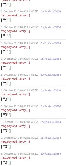

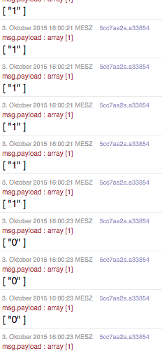

Only when I am using a virtual button (V5 in my example) I get multiple “1” and “0” values. - not sure if this is related to Blynk or Node-RED?

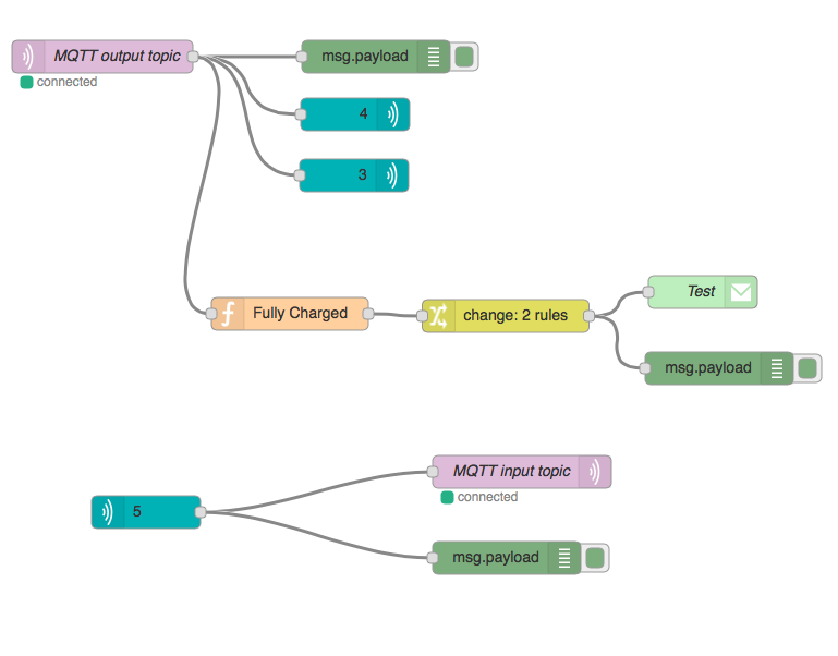

Here is my small testsetup:

@odyssey thanks for your kind words. as i said, first time doing this, but i have not seen it behave like it did to you yet.
things i would immediately try is:
-restart node-red server and try immediately after (maybe i need to deregister some events on redeploy)
-have a sketch with just one node red node and see if that works properly (again, some bug in how i register / keep track of events)
-check if you didn t add multiple keys in the edit panel by chance, don t think it would work at this point
@odyssey found the bug, it seems to be reregistering events every time you redeploy.
i ll try and fix
/edit uploaded a fix in 0.0.3
Thanks for the fix! It’s working fine now :smile:
