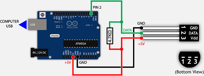

After that, I did a small PCB (I enjoy soldering small boards… call me crazy
) because a 4.7k pull-up resistor must be connected to the 1-wire bus.
The code is like this:

And some photos:
Let me know your comments!
